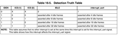

1. How can i enable the idle line detection for my UART1 ?
2.How can i set the ICD frame as 16 frames ?
