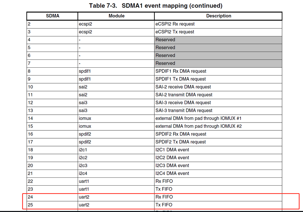

Now I used the imx8mq board and I see the uart2 event map to the 24 and 25 channels of sdma1 as blew:
Can I map the uart2 to the channel of sdma2, if it can, how can I set it ?
Thanks.

igorpadykov
Hi Hongxing
if you have special need for changing default sdma configuration
suggest to apply to :
Commercial Support and Engineering Services | NXP
igor
4,598 Views
igorpadykov
Hi Hongxing
not, sorry.

igorpadykov
Hi Hongxing
one will have to write custom sdma script.
igor

igorpadykov
Hi Hongxing
>Which scrpit, could you show me a reference ?
sorry writing custom scripts is not supported by NXP.
So one will have to use existing scripts.
