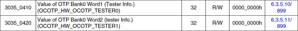

and then,the table below relate to UNIQUE_ID.
The second column shows that UNIQUE_ID has 64 bits,and SJC_CHALL has 64 bits.
But the third column shows that this field(0x420) only has 32 bits,I don't know which part is of UNIQUE_ID,what does SJC_CHALL mean.
I tried to search "SJC_CHALL" and "UNIQUE_ID" in whole document,But no response.
These confuse me a lot.
I tried to use fuse cmd which provided by uboot to read the unique_id.0x420 belong to bank 0 word 2.
u-boot=> fuse read 0 2
Reading bank 0:
Word 0x00000002: 070891d6
u-boot=> fuse read 0 2 3
Reading bank 0:
Word 0x00000002: 070891d6 00000000mxc_ocotp fuse_read(): Invalid argument
ERROR
It seems that only can read 2 fuse word.

To understand how to calculate the bank and word, using the address: look at OCOTP memory map in
section 6.3.4 (OCOTP Memory Map/Register Definition) of i.MX 8M Mini Reference Manual,
Rev. 2, 08/2019 :
3035_0400 - Bank 0 Word 0
3035_0410 - Bank 0 Word 1
3035_0440 - Bank 1 Word 0
  So, formula is as following:
  Bank = (address - 0x400) / 0x40 ;
  Word = [(address - 0x400) % 0x40] / 0x10 ;
In this case, you will look for the address 0x410 to 0x430:
u-boot -> fuse read 0 1 3
Hope this can help you.
Diego.
