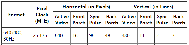

Actually, I refer from below data. from googling.
But this make shifted output.
My upper setting value makes better output. Like this :

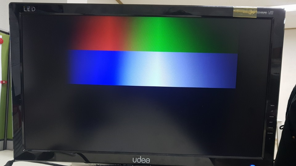

This Image is 4 seperated color that (R 255), (G 255), (B 255), (R255G255B255).
Red and green, blue and white's boarder line looks like gradation.
My original image is this : (640 x 480)
At this time, fbset's result is
mode "640x480-62"
# D: 25.176 MHz, H: 31.469 kHz, V: 61.826 Hz
   geometry 640 480 640 480 32
   timings 39721 16 48 2 25 96 2
   rgba 8/16,8/8,8/0,8/24
endmode
PCLK and VSYNC is holded.
but HSYNC looks like jitter. (little bit.. shaking..)
I cannot understand..

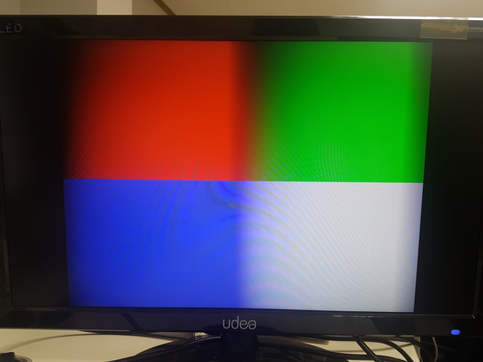

So I tried another timing and resolution.
I setted
"1280x960", // name
60, // refresh
1280, // xres
960, // yres
9794, // pixclock
216, // left margin (HBP) Back Porch
80, // right margin (HFP) Front Porch
30, // upper margin (VBP) Back Porch
1, // lower margin (VFP) Front Porch
136, // Hsync Length
3, // VSync Length
FB_SYNC_CLK_LAT_FALL, // Sync
FB_VMODE_NONINTERLACED, // Vmode
0,},
And result is
Image size is 640x480 and resolution is 1280x960
so, I understood height is half.
but I cannot understand why width is not half..
Most of all,
Left and middle's border line looks like blur and gradation..
How can I found the exact timing for 640 480 resolution?

호영노
This problem is not caused by timing..
It was solved by remove the RGB capacitor.. lol.....
