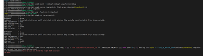

Hello, we use imx93 and the lastet bsp 6.12.20-2.0.0. Now we want to boot from nandflash and we have confirmed th imx93 support this. But when we use uuu to flash the nandflash, it always report a error like this:

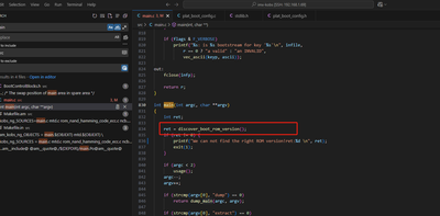

which report "we cant find the right rom version" by kobs-ng, so we read the source code form git, and we find kobs-ng not support imx93. So, it's my misunderstand? And can you help me to solve the problem. Thank you very much!

Which like ranYang's said,the first we try the uuu eexample-script, and it stucked at kobs-ng. And today we try the another script which from 把手教你以 Standalone 方式编译(八)- NAND Flash

But, it still stuck the fspinand cmd, and it report follow error:
[2025-06-30 10:21:07]  u-boot=> fspinand init spi-nand0 ${fastboot_buffer} ${fastboot_bytes}
[2025-06-30 10:21:17]  Unknown command 'fspinand init spi-nand0' - try 'help'

pengyong_zhang
please use the uuu -b nand <bootloader> command
nand burn boot loader to NAND flash
arg0: _flash.bin bootloader
arg1: _image[Optional] image burn to nand, default is the same as bootloader
