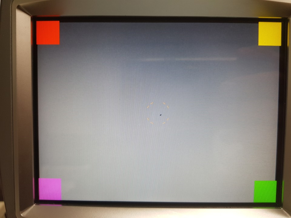

I'm using the imx6dual for my project.
I finished overlay the camera image(using the V4L2) on the QT Application(GUI Based.) on the LVDS.
But,
In the LVDS screen, camera image is not full for LVDS (640x480).
QT GUI is perfectly fit with LVDS.
Look at this :
(gray screen is camera image. )
And 4 colored rectangle is on the QT Application.
Each rectangle is positioned each corner.
But Camera image is not fit with each rectangle.

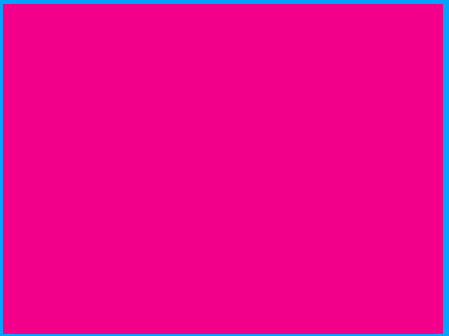

It looks like,
V4L2 has a margin like this :
(pink is camera area,
blue is gui area.)
What can I do for this?
Actually, I tried this from example of internet source..
So I cannot know how can I access this problem...
※ This Camea is fit with same LVDS when I use another CPU.
So I think that this is not problem of LVDS or Camera's setting.
Below Code is sample code what I referred.
This code is working same as my QT Program.
It has same margin.
If you need see a some another code, please reply to me.
Thank you for your help.
