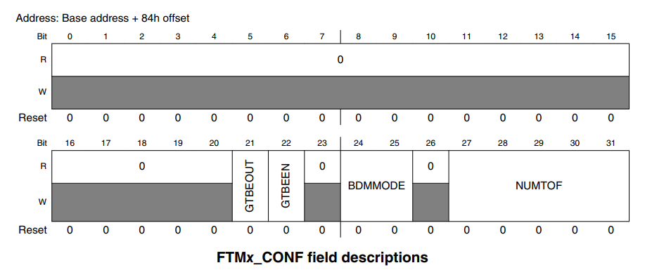

Hi, I am working on configuration of Flextimer in Quadrature Decoder mode. Does anyone know the what is the function of BDMMODE bits in FTMx_CONF register?

Hello Tanmay,
When the chip is in an active BDM mode, the FTM temporarily suspends all counting until the chip returns to normal user operating mode. During Stop mode, all FTM input clocks are stopped, so the FTM is effectively disabled until clocks resume. During Wait mode, the FTM continues to operate normally
