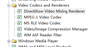

Zenger1978
Thanks for your answer . I have added SYSGEN_DSHOW_VMR in my catalog item. Are there others renderer components ?https://community.nxp.com/discussions/83-render.PNG" target="_self

PrabuKumar
Are you trying with WinCE 6.0 Or WEC7? If you are trying with WEC7,check whether you have the renderer component from the catalog item.
