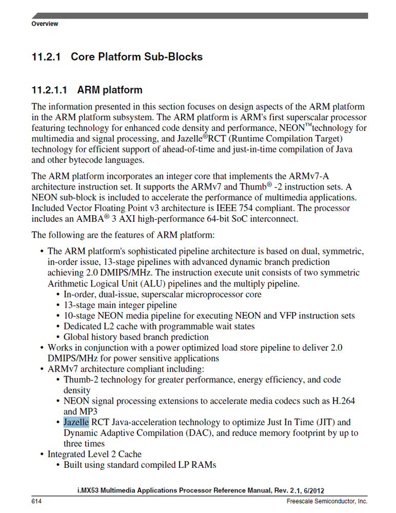

Hi all,
I need information about how/where to find an hw accelerate JRE, with a browser plugin for Firefox/Chromium/Midori, for the i.MX53.
I have to use a web browser on an i.MX53 board, to visualize some pages from a web server. These pages require an Oracle JRE (unfortunately these pages doesn't work with OpenJDK)
I tested all the system with Firefox, Midori and Chromium using both the Oracle ejre1.6.0_38 and the ejre1.7.0_10 (with their web browser plugin), and all of them work, but very very slowly.
Some pages require tens of seconds before a complete visualization and the jre process takes the 99% of the CPU.
So I hope to find a JRE able to take advantage of the hw Java acceleration of the i.MX53 processor (Jazelle, ThumEE, ...), but I didn't find anything yet.
Did someone find a this kind of JRE ?
Thanks and best regards,
Flavio

jamesbone
Unfortunately the i.MX53 does not have a HW acelerated module,  we can recommend to use the i.MX31 which already contains the Jazzelle.
http://www.freescale.com/iMX31
Jaime

Hi Jaime,
thank you for your help, but I'm a little bit confused now, since Jazelle is one of the Cortex A8 features and since in the manual:
     "i.MX53 Multimedia Applications Processor Reference Manual"(Document Number: iMX53RM - Rev. 2.1, 06/2012)
at page 614 you can see:
Jazelle RCT Java-acceleration technology to optimize Just In Time (JIT) and
Dynamic Adaptive Compilation (DAC), and reduce memory footprint by up to
three times
So is the manual wrong?
Flavio
