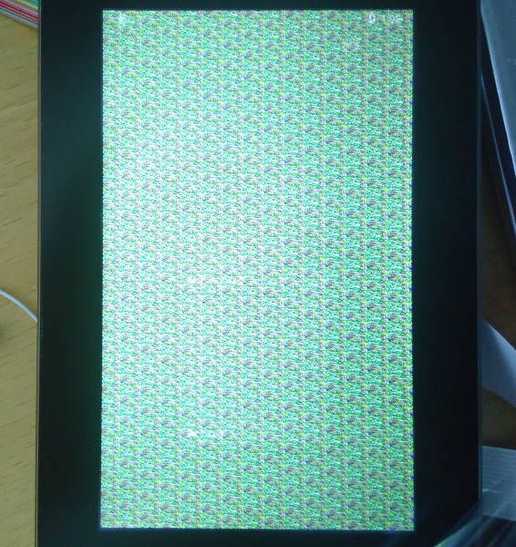

Hi everyone,
on a custom IMX6Q-Board with 4 GB DDR3 RAM running Android O8 we have an issue concerning hardware overlays. Everything seems to work fine. But when starting an application the display shows for 2-3 seconds a greenish kind of pixel mess, which vanishes again, if the application has finished loading:
These display errors disappear if I disable overlays (Developer options/Disable HW overlays). Hence why I think it is a hardware overlay issue of the GPU.
DDR3 RAM was calibrated on our board using stress test tool V2.92.
And I found some older thread mentioning a similar behaviour when using more than 2 GB RAM. And indeed overlays work, if I limited the RAM to 2 GB using mem=2GB kernel parameter. As one mentioned solution was to change the GPU base address in the device tree, I checked the current settings. But as far as I can tell the GPU physical base address is already set to the suggested value in the imx6q.dtsi device tree file:

12,238 Views
jhkim3
I think I found the cause of the problem.
Try to use only cma in the mxc-ion section of the device tree.
(arch/arm/boot/dts/imx6qdl.dtsi)
As follows:
         imx_ion {
             compatible = "fsl,mxc-ion";
             heap_cma@0 {
                 compatible = "fsl,cma";
                 heap-name = "cma";
                 heap-type = <4>;
                 heap-id = <0>;
             heap_sys_contig@0 {
                 compatible = "fsl,sys-contig";
                 heap-name = "sys-contig";
                 heap-type = <1>;
                 heap-id = <1>;
             heap_sys@0 {
                 compatible = "fsl,system";
                 heap-name = "system";
                 heap-type = <0>;
                 heap-id = <2>;
If it is resolved, the reason is as follows.
As in the answers above, the GPU can only handle physical memory in the 0x10000000 to 0x80000000 area.
But if you use more than 2GB (like us 4GB)
The linux HIGH_MEMORY area is included from 0x80000000 to 0xFFFF0000.
Then, there is a case that ION SYSTEM CONTIG allocates an area of 0x80000000 ~ 0xFFFF0000 and informs the GPU.
That's why this happens.
NXP would never have tested OREO8 at 4GB.
Since they are not using ION SYSTEM CONTIG in versions prior to OREO8, they would have concluded that there is no problem at 4GB.
If you see a fix, please let me know as soon as possible.
(The content can be awkward because I am using a translator. please understand.)

thomaselste
Hello Kim,
that's great news! I've disabled all the ION memory sources in the device tree except the CMA one as you suggested. And the overlay errors are completely gone! Graphic effects are looking normal to me, now.  Looks to me as you really did find the solution for this problem.
My setup is now: CMA area below 2 GB defined in the device tree, no cma kernel command line parameter and ION using only CMA as source
I never thought of that the Android graphics systems might be using ION to allocate some buffers above the 0-2 GB range and hand them to the GPU for processing/displaying.
Thank you very much for investigating this and coming up with this solution
Thomas

Bio_TICFSL
Hi Thomas,
Are you seeing this greenish kind of pixel mess on all application or any specific application? If it is specific application, can you please provide the same?"
12,237 Views
thomaselste
thank you for your reply. It happens every time for 2-3 seconds when an overlay animation gets displayed by Android. For example if you start a new application (doesn't matter which). After these 2-3 seconds, the display returns to normal again. If I had to guess, I would say something with the overlay framebuffer or its allocation isn't right. But for a simple "overlay framebuffer memory is overwritten" the pattern seems to be to regular.
Thomas

Bio_TICFSL
Hi Thomas,
GPU hardware has limitation to access the physical memory address > 0x80000000, for 4GB memory, you can assign CMA memory to low 2GB memory in device tree to avoid such issue:
Kernel: arch/arm/boot/dts/imx6q.dtsi
Modify to following:
linux,cma {
                        compatible = "shared-dma-pool";
                        reusable;
                        alloc-ranges = <0x40000000 0x40000000>;
                        size = <0x40000000>;
                        linux,cma-default;
 It means that CMA address begin from 0x40000000, CMA size is 0x40000000(1GB), 0x40000000 + 0x40000000 = 0x80000000.
You can adjust this two values, just make sure that CMA begin and end address < 0x80000000

We have the same problem.
U-Boot 2017.03 (Apr 25 2019 - 14:38:58 +0900)
CPU:   Freescale i.MX6Q rev1.5 996 MHz (running at 792 MHz)
CPU:   Extended Commercial temperature grade (-20C to 105C) at 58C
Reset cause: POR
Model: Freescale i.MX6 Quad SABRE Smart Device Board
Board: MX6-SabreSD
DRAM:  3.8 GiB
[    0.000000] Booting Linux on physical CPU 0x0
[    0.000000] Linux version 4.9.17 (jhkim@spfw3) (gcc version 4.9.x 20150123 (prerelease) (GCC) ) #29 SMP PREEMPT Thu Apr 25 11:06:44 KST 2019
[    0.000000] CPU: ARMv7 Processor [412fc09a] revision 10 (ARMv7), cr=10c53c7d
[    0.000000] CPU: PIPT / VIPT nonaliasing data cache, VIPT aliasing instruction cache
[    0.000000] OF: fdt:Machine model: Freescale i.MX6 Quad SABRE Smart Device Board
[    0.000000] cma: Reserved 448 MiB at 0x2a000000
[    0.000000] Memory policy: Data cache writealloc
[    0.000000] percpu: Embedded 15 pages/cpu @f76bd000 s31040 r8192 d22208 u61440
[    0.000000] Built 1 zonelists in Zone order, mobility grouping on.  Total pages: 981263
[    0.000000] Kernel command line: console=ttymxc0,115200 init=/init video=mxcfb0:dev=ldb,if=RGB24,bpp=32 video=mxcfb1:off video=mxcfb2:off video=mxcfb3:off vmalloc=128M androidboot.console=ttymxc0 consoleblank=0 androidboot.hardware=freescale cma=448M galcore.contiguousSize=33554432 androidboot.selinux=permissive buildvariant=userdebug androidboot.serialno=1907b9d4ee6a3958 androidboot.soc_type=imx6q androidboot.storage_type=emmc
[    0.000000] PID hash table entries: 4096 (order: 2, 16384 bytes)
[    0.000000] Dentry cache hash table entries: 131072 (order: 7, 524288 bytes)
[    0.000000] Inode-cache hash table entries: 65536 (order: 6, 262144 bytes)
[    0.000000] Memory: 3419596K/3932156K available (12288K kernel code, 967K rwdata, 3960K rodata, 1024K init, 579K bss, 53808K reserved, 458752K cma-reserved, 3022844K highmem)
(view in My Videos)
How can I solve this problem?
We connected Micron DDR3L MT41K512M16 x 4.
At the same ddr setting,
Only the MMDC1_MDCTL[17:16](DDR data bus size) bits could be controlled to change to 4GB or 2GB.
DATA 4, 0x021b0000, 0x851A0000 // 4GB
DATA 4, 0x021b0000, 0x85190000 // 2GB
The above problem occurs when setting 4GB, There is no problem when setting 2GB.
It does not seem to be a timing issue, nor is it a circuit problem.

thomaselste
unfortunately the problem with our board persists, too. Btw: We are using the same DDR ICs: MT41K512M16
Thomas

thomaselste
sorry for my late reply. I was only now able to try out your suggestion.
My imx6q.dtsi didn't contain the linx,cma node, so I've added a complete reserved-memory entry:
reserved-memory {
   #address-cells = <1>;
   #size-cells = <1>;
   ranges;
   linux,cma {
      reusable;
      linux,cma-default;
I had to remove the cma parameter from the kernel command line, or else the DT entry was ignored. Now the kernel seems to use the values correctly. The kernel log shows:
Reserved memory: created CMA memory pool at 0x40000000, size 1024 MiB
OF: reserved mem: initialized node linux,cma, compatible id shared-dma-pool
Unfortunately this doesn't change anything regarding the overlay not showing correctly:
To get some more information, what is going on, I've tried to enable some additional output of the video driver using the galcore.showArgs=1 parameter. Maybe this helps narrowing down the error:
Galcore version 6.2.2.96445
Galcore options:
 irqLine = 20
 registerMemBase = 0x00130000
 registerMemSize = 0x00004000
 irqLine2D = 21
 registerMemBase2D = 0x00134000
 registerMemSize2D = 0x00004000
 irqLineVG = 22
 registerMemBaseVG = 0x02204000
 registerMemSizeVG = 0x00004000
 contiguousSize = 0x04000000
 contiguousBase = 0x00000000
 bankSize = 0x00000000
 fastClear = -1
 compression = -1
 signal = 48
 powerManagement = 1
 baseAddress = 0x10000000
 physSize = 0x80000000
 logFileSize = 0 KB
 recovery = 0
 stuckDump = 0
 gpuProfiler = 0
 irqs = -1,
-1, -1,
-1, -1,
-1, -1,
-1, -1,
-1,
Thank you for your reply. Best regards
Thomas
