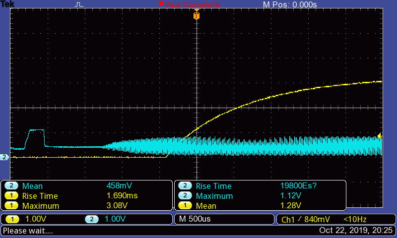

annie_varshitha
i have attached the waveform of POR_B and 24MHz crystal. Kindly suggest if there are any other parameters causing this issue.F0039TEK.BMP@

igorpadykov
Hi Annie
such issues usually are caused by crystal quality (non-stability)
issues and poor soldering. One can check Hardware Guide (available on processor web
product page) for crystal accuracy requirements and try to resolder problematic boards.
igor
