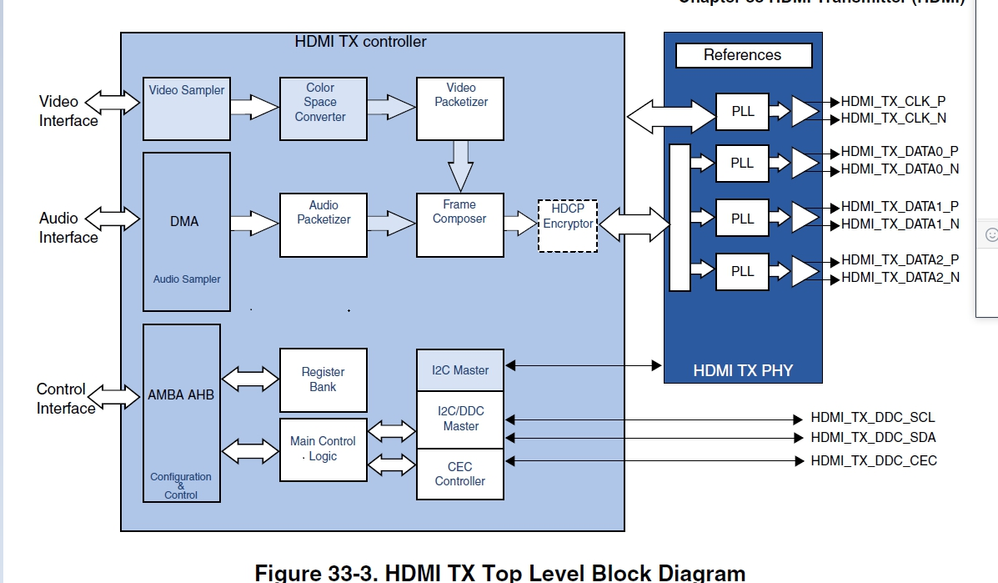

Hi Community,
I'm working on i.MX6 Quad sabre-SD platform and build Android 6 for my image.
I tried to disabled HDCP in dtsi file like below.
&hdmi_video {
fsl,phy_reg_vlev = <0x0294>;
fsl,phy_reg_cksymtx = <0x800d>;
pinctrl-names = "default";
pinctrl-0 = <&pinctrl_hdmi_ddc>;
/*fsl,hdcp;*/
status = "okay";
And my HDMI can not display.
I had modified driver mxc_hdmi.c like below.
static int mxc_hdmi_probe(struct platform_device *pdev)
    struct mxc_hdmi *hdmi;
    struct device *temp_class;
    struct resource *res;
    int ret = 0;
    /* Check I2C driver is loaded and available
    * check hdcp function is enable by dts */
    hdmi_hdcp_get_property(pdev);
    if (!hdmi_i2c) //&& !hdcp_init)
        dev_err(&pdev->dev, "forenex victor HDMI dead\n");
        return -ENODEV;
But it still send forenex victor HDMI dead to me on the console and HDMI not display either.
How can I display without settings HDCP?
Thanks in Advanced!

wangtsungli
Hi igorpadykov
Thanks for your reply.
For imx6q-sabresd-hdcp.dts has enable HDCP in hdmi_core.
And imx6q-sabresd.dts enable HDCP in imx6qdl-sabresd.dtsi which it has include it.
Both dts that you recommend has enable HDCP.
But in my case I hope to disabled HDCP.
And I found out that boundary source code did not enable HDCP.
But they use I2C Master instead of DDC_SCL and DDC_SDA.
Is HDCP matter which I2C that we use?
1,904 Views
igorpadykov
no, I think HDCP does not matter which I2C used.
igor
