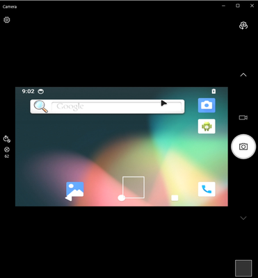

I am evaluating i.MX 8ULP Evaluation Kit, with a Full-HD HDMI monitor and the monitor displayed "no signal" when the EVK was booted with default OS image, but I can see the messages displayed in debug console, suggesting that it was booting but problem with HDMI.
Subsequently i downloaded latest Android Image Android 14.0.0_1.2.0 and flash it with command:
PS D:\android-14.0.0_1.2.0_image_8ulpevk> .\uuu_imx_android_flash.bat -f imx8ulp -a -e -u trusty-dual -d hdmi
Same thing observed which the HDMI is not displaying. Then I try to use a HDMI to USB video capture adapter and I saw the Android screen displayed on my Windows camera app.
Checking the size of display using debug console
evk_8ulp:/ $ wm size
Physical size: 720x480
Checking the latest release notes Android Release Notes (nxp.com)
The maximum resolution is HDMI 720x480.
  1. What is the reason for this limitation?
  2. What HDMI monitors were being tested with i.MX 8ULP EVK Android and Yocto Images?
  3. Any other suggestions?
