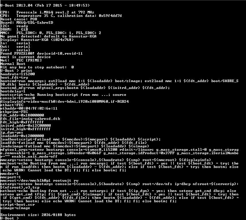

I am attempting to boot the SABRE SDB using ArchLinuxARM-armv7-latest.tar.gz, u-boot.imx, and SABRE_SDB.dtb.  I can get the board to boot all the way to root, but can only see the terminal through the Serial USB connector.  At the terminal I remove the HDMI cable and reconnect it, but no message appears.  I don't know if edid is active or if I'm missing some HDMI drivers.  I will post the output of the uboot screen below (attached):
Thanks in advance

Hi Joseph Alejandro,
You do not miss some HDMI drivers. No message appears in terminal is normal because HDMI Hot plug is not support.

I still am not showing anything through the HDMI. Nothing appears to happen upon bootup. No light change on the HDMI monitor or anything. In the past, I have seen at least the monitor change to the HDMI input on boot. With this boot I get nothing. Any suggestions?

Hi Alexjandro,
What the information on the terminal when the board boot up? Can you show it to me?
