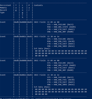

I have error in this picture. How can i solve this problem.

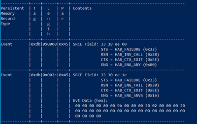

From the HAB_INV_CALL error, it seems like the call to hab_rvt.entry or exit is done out of sequence.
What device and version of BSP you are working with?

I use IMXRT1171. It has HAB 4.5 version.
I didnt understand this error.
I dont know what I do.

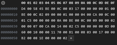

This is my HAB Commands.
There are certificates and sign's with starts 0xD7 and 0xD8 tag. in the defined addresses.
(0xD8/0xD7 - size - version - certificate/sign)

The HAB event you report seem to indicate HAB_FAILURE, due to the reason of HAB_UNS_STATE (Unsuitable state ) and HAB_ENG_FAIL  ( Engine failure).
To dive into errors I like to use the Appendix A: Interpreting HAB Event Data from Report_Event() API from the High Assurance Boot Version 4 Application Programming Interface Reference Manual contained in the CST( code signing tool) However, the manual does not dives into details, as we would like in this occasion, I apologize for this.
If HAB is enabled succesfully, you should not receive error events, and sometimes you can get warnings.

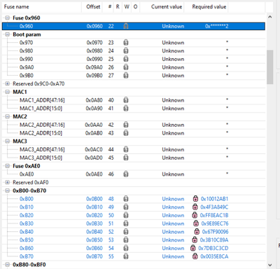

To enable HAB, we need to burn from  0xB00 to 0xB70  for the SRK and the 0x960 to enable HAB, as shown in the write scripts of the MCUXpresso Secure Provisioning Tool. Did you miss this fuse?

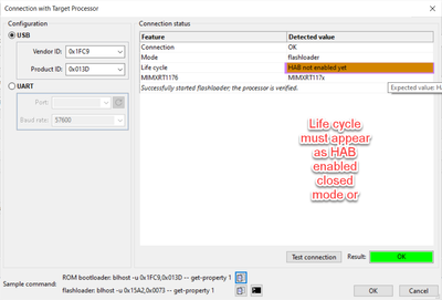

If you ping your RT1170 over USB (using the SPT or the blhost get-property command), can you see that the life cycle is set to close?
