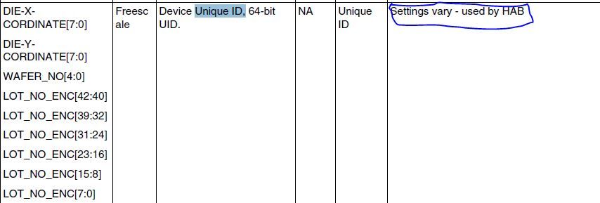

Hi All,
I have gone through some of security appnotes AN4581& DL reference manual and imx6 security reference manual.
From imx6 DL ref manual section: 8.3.1
          FUSE                              Configuration                                   Definition                                                         Shipped value                                        settings
DIE-XCORDINATE[                  Freescale                         Device Unique Id, 64-bit UID                                            NA Unique ID                  Settings vary - used by HAB
7:0]
DIE-YCORDINATE[
7:0]
WAFER_NO[4:0]
LOT_NO_ENC[42:40]
LOT_NO_ENC[39:32]
LOT_NO_ENC[31:24]
LOT_NO_ENC[23:16]
LOT_NO_ENC[15:8]
LOT_NO_ENC[7:0]
nxp above key has  burned to the chip.
  •    How the settings vary, if we used HAB secure boot flow? what kind of system settings  will vary?
  •   Can i know , how Unique_ID keep the board/device  in secure state?
  •    If Because of Unique id the system in secure state. so will be in the same state remain, if we start without additional checks for HAB secure boot in the same state?
  •     Can you please give point, how to read unique iD through bare-metal app.
can you please confirm above points.

As per Imx6 DQ Ref. Manual in section:8.3.1.
InBoot  Efuse table given "Setting vary -used by HAB"? I didn't find any explanation for this, Can you breief about this?

Yuri
This means, that the UID field must not be empty.

Hi All,
Mean while, we tried for reading OCOTP_CFG0, OCOTP_CFG1 register values in two imx6 DL boards.
we have used simple bare-metal code for reading OCOTP_CFG0(0x021BC410) and OCOTP_CFG1(0x021BC420).
We got same 64 bit vale on two diffrent boards, how it is same value?

dhanunjay
Sorry for the second question confusion. we have veirfied  on two boards its diffrent UNIQUE IDs.

Yuri
1.
The  UID as  a unique value (such as a serial number), assigned to each processor
during fabrication, is not used by boot ROM for HAB approach.
2.
   Please look at the following How to read i.MX6DQ unique ID.
