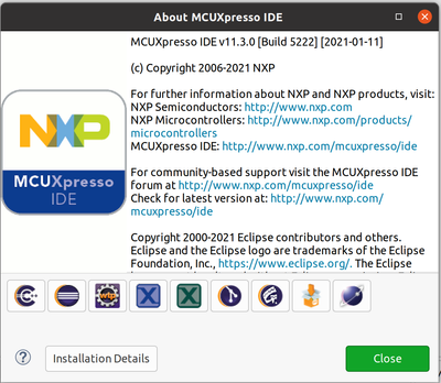

I've created an SDK online for the iMX8QM  MIMX8QM6xxxFF target.
When I drag the downloaded SDK into MCUXpresso IDE I get an error.
Here is the error log:
[/home/xxxx/Downloads/SDK_2.9.0_MIMX8QM6xxxFF.tar.gz]

 Any idea what the problem could be?
Solved: The problem turned out to be selecting "GCC" for the Required Toolchains when I should have selected "MCUXpresso IDE" when building the SDK online.
