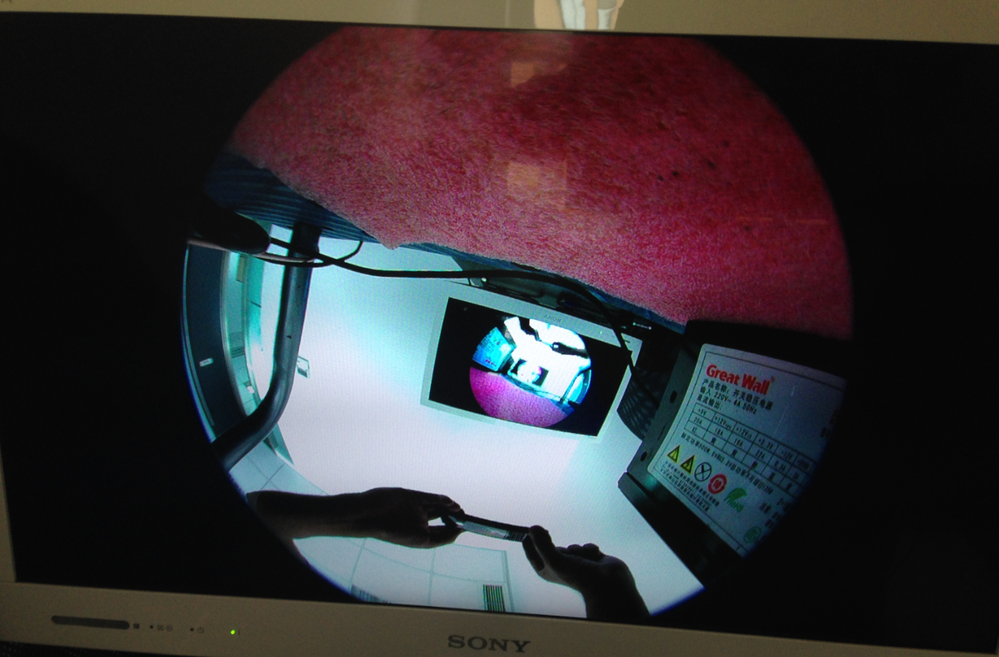

Here is the update for the issue.
  • Input device IMX6 CSI1 to connect capture devices: SII9135 HDMI receiver(input format: 16bit, YUYV, 1920x1080)
  • Output device: IMX6 integrate HDMI output.
1. Using IMX6 test program, we can get correct video bypass output.
The test command we are using is below:
>./mxc_v4l2_overlay.out -m 4 -iw 1920 -ih 1080 -it 0 -il 0 -ow 1920 -oh 1080 -ot 0 -ol 0 -r 0 -t -1 -d 0 -fg -fr 30 -di /dev/video1 -do /dev/video16
/dev/video1 is Sii9135 input device, video16 is HDMI output device. the output is correct as below,
2. Using Gstreamer pipeline, the video output is wrong, the command is below:
>./gst-launch-0.10 -v 'mfw_v4lsrc device="/dev/video1"' ! 'video/x-raw-yuv, format=(fourcc)I420, width=1920, height=1080' !    mfw_isink
The two photo of the output is below:
The video is blinking and with color bar.
We think that maybe colorspace mismatch between the video source and sink, the sii9135 input is YUYV-16bit, but the pipeline is using I420 format.
The gstreamer plugin(version 3.0.7) "mfw_v4lsrc" seems using a fixed pixformat "I420", is it the problem?
