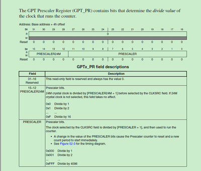

Dear NXP,
I have found to get the right microseconds (us) then I need to multiply by 3 the return of GPT_GetCurrentTimerCount()
Is this expected?
Example: evkmimxtrt1160_gpt_timer_cm7
Creates a 1 second interrupt
If I measure the difference between each interrupt
uint32_t us_count1(void)
return GPT_GetCurrentTimerCount(GPT1);
gpt1_previous = gpt1_current;
gpt1_current = 3 * us_count1(); // <---- HERE multiply by 3
gpt1_difference = gpt1_current - gpt1_previous;
PRINTF("GPT1 %d\n\r",gpt1_difference);
Then I get
GPT1 981396
981396us =(approx) 0.98 seconds
Just wanted to know if this is documented somewhere?

Hi @kerryzhou I solved this issue, I want to share what I found.
Original code :  GPT_SetClockSource(GPT1, kGPT_ClockSource_Osc);
It was not obvious about what speed the OSC clock was running. Which is why it confused me why 3x - it seems this was a "red herring" or I made the wrong assumption about what frequency the OSC clock was running.
Here a more robust solution:
Then I changed this to  GPT_SetClockSource(GPT1, kGPT_ClockSource_Periph);
Seems like some documents say this is 150MHz but actually I found something different.
At least on the RT1160 board I have it seems this clock source is actually 24MHz
Since then I divided by 24
GPT_SetClockDivider(GPT1, 24);
Which gives 1MHz or 1us
I was able to confirm this because I setup GPT2 to generate an interrupt at 1 second intervals.
I could see the log output on the terminal correlated to 1 second.
Then I used the GPT1 counter to confirm e.g. GPT_GetCurrentTimerCount(GPT1)
The elapsed time between the previous interrupt and the current interrupt.
So the number of ticks of my GPT1 @1us was of course approximately 1,000,000 = 1,000,000us = 1 second

Hi @neo2 ,
   3X is not the fixed one, it is determined by your clock divider.
   Let me know, why you need to divide 3, please check the code:
/* Divide GPT clock source frequency by 3 inside GPT module */
GPT_SetClockDivider(EXAMPLE_GPT, 3);
/* Get GPT clock frequency */
gptFreq = EXAMPLE_GPT_CLK_FREQ;
/* GPT frequency is divided by 3 inside module */
gptFreq /= 3;
So, your register divide 3, then your clock need to divide 3.
