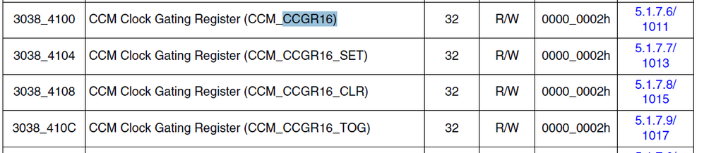

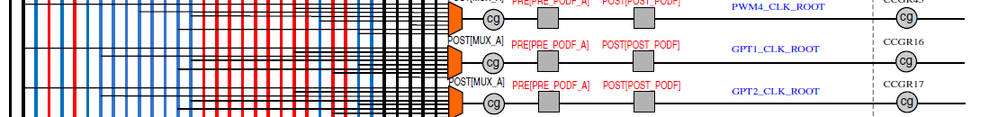

So what registers are we interested in?  Well, taking a look back in the SoC Reference Manual, we can look at the clock tree to determine where the problem could be:
So there is a mux that could have changed, pre and post dividers, as well as a clock gate (CCRG16):

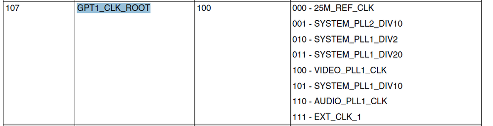

Now, we need to find what manages the GPT1_CLK_ROOT:
So clock slice 107 controls the clock root, need to find that register:

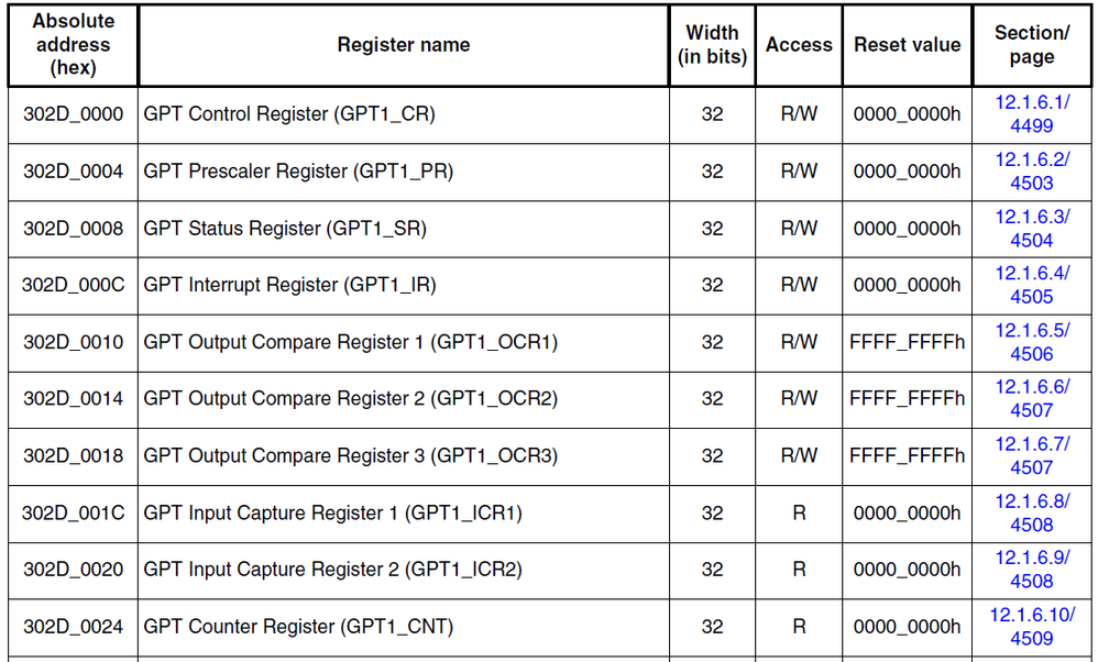

We would also like to look at the GPT configuration, just in case that changed:
Going back into u-boot, let's peek and poke those registers!:

u-boot=> md 0x30384100 1                         # Clock gate CCGR 16
30384100: 00000032                               2...

u-boot=> md 3038b580 1                           # Clock source 107
3038b580: 12000003                               ....
u-boot=> md 302d0000 1                           # GPT1 configuration
302d0000: 0000006b                               k...
u-boot=> md 302d0004 1
302d0004: 00000002                               ....
u-boot=> md 302d0008 1
302d0008: 00000000                               ....
u-boot=> md 302d000c 1
302d000c: 00000001                               ....
u-boot=> md 302d0010 1
302d0010: 01fca055                               U...
u-boot=> md 302d0014 1
302d0014: ffffffff                               ....
u-boot=> md 302d0018 1
302d0018: ffffffff                               ....
u-boot=> md 302d0024 1
302d0024: 010096c3
Ok, that's great.  We see the configuration of both the basic clocks and the GPT1.  Next, let's boot Linux and see what changes (note that you will need to build the validation image OR add unit_tests to your build):

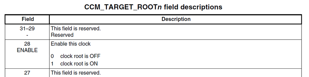

root@imx8mqevk:/unit_tests# ./memtool 0x3038b580 1
E
Reading 0x1 count starting at address 0x3038B580
0x3038B580:  02000003

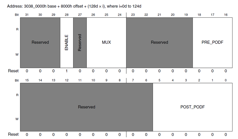

OK, whoa!  Something changed, what is this bit?  Back to the Reference Manual:
Ouch, Linux turned off our clock!!  What the heck, man?!
