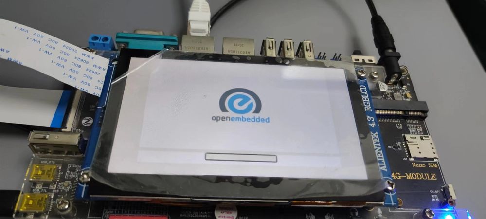

The kernel source code compiled by yocto will directly run the official qt demo when the screen is working normally. How to close it? What files need to be modified?

You could compile the image (without QT) in Yocto BSP.

  I think it should be the easiest way to close the official qt demo and run my own qt program now, but now I don't know how to close the official qt demo.

You could search the .bb file of the "image name" you build in yocto. Then there is something like qtbase bb file for building the QT. Then you could search the "gui" option in the content of bb file. Remove the "gui" option from the building.

 Thank you for your reply, if I use the bsp without qt, will the qt program not be able to run normally?
