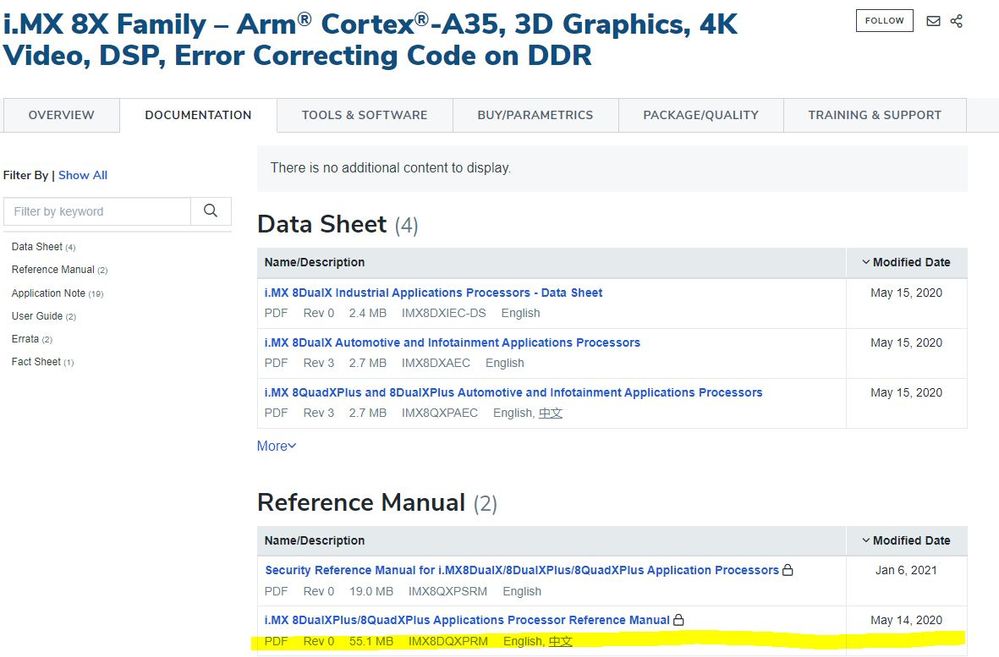

base on this , you can read the proceesor and board reference manual , not short one , but some50mb pdf file and about  9111 pages references manual one(for my board imx8qxpmek , yours also about 6000pages if i m not wrong), to read every things insides and
to find what port u can use lah
