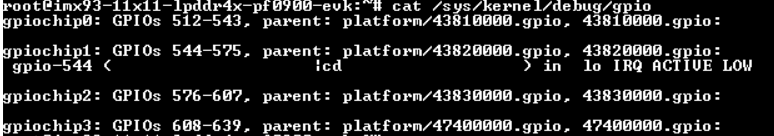

I'm working on the IMX93 board bring-up. During testing of the RS485 peripherals, we used one of the GPIO pins (i.e., GPIO2_IO00) to toggle between logic 0 and logic 1.
While researching resources about GPIO configuration for the IMX93, I came across the method to find GPIO numbers using:
cat /sys/kernel/debug/gpio
Our board is based on the IMX9352 processor. For GPIO2_IO00, I used the GPIO number 512,
and it worked correctly for the board. but, I would like to understand how this GPIO is configured. How is the GPIO number calculated for the IMX93 processor? Is there a specific formula for determining this? If so, could you please provide it?

Linux kernel base the GPIO number based on the index, in this case:
  • gpiochip0: GPIOs 512-543, parent: platform/43810000 (real GPIO is GPIO2)
  • gpiochip1: GPIOs 544-575, parent: platform/43820000 (real GPIO is GPIO3)
  • gpiochip2: GPIOs 576-607, parent: platform/43830000 (real GPIO is GPIO4)
  • gpiochip3: GPIOs 608-639, parent: platform/47400000 (real GPIO is GPIO1)
But as I said, Linux kernel take as reference the index, so Real index:
  • Real GPIO2 is Index 0
  • Real GPIO3 is Index 1
  • Real GPIO4 is Index 2
  • Real GPIO1 is Index 3
You can use this formula to calculate your desired pin:
GPIO_NUMBER = GPIO_BASE_INDEX + PIN_INDEX
As example, we can take the GPIO2_IO00:
GPIO_NUMBER = (512) + (0) = 512.

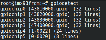

Also, you can take a look to the gpiod tool installed by default in our BSP. It is easy to use (gpiodetect, gpioset, gpioget, etc.):
