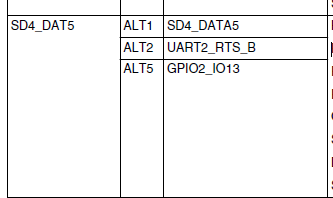

Refered the datasheet found this pin can be used for three purpose.
SD4_DATA5 I am not using and UART2_RTSB also i have checked i am not using this functionality also. In that case GPIO2_IO13 should work.
Do you have nay other pointers?
