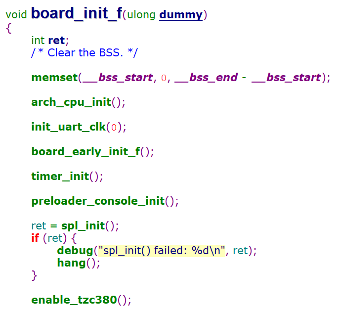

When the IMX8MQ SoC is powered on, the UBOOT initializes GPIO in the BOARD_EARLY_INIT_F function.However, GPIO is not controlled at the moment of power on, what should I do to achieve such control effect?thank you.

I did GPIO initialization in the board_early_init_f () function, which should be earlier than the method initialization you mentioned, but it will take 200ms to run this function after power on.

yes,I initialize the GPIO in spl_board_init(), and I still can't pull the GPIO up or down when I power it up.
