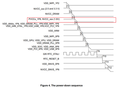

My customer asked about GPIO with the following conditions.
Please check whan GPIO can be best choice to meet the condition below.
Pin : GPIO5_IO18, GPIO1_IO7, GPIO3_IO1
Condition :
- To assign GPIO for Reset of Other Devices
- GPIO remains in a stable Pull-Up state even when i.MX 8MM is initialized or restarted.
Please let us know what pin can be the best option to avoid glitch or unknown state during reset.

Zhiming_Liu
The NVCC_xxx will be pull down during reset.
