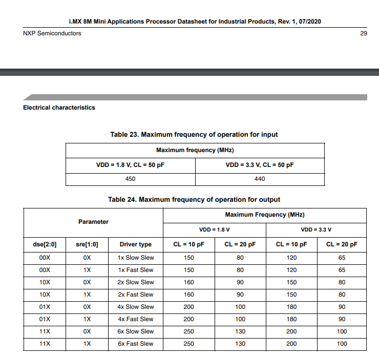

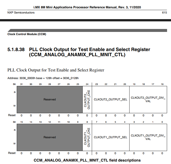

Aubineau_FAE
Max GPIOs frequency is in the datasheet:
If you want to output a clock, you have CLKOUT1 & CLKOUT2 pins for this purpose, as described in the reference manual:
