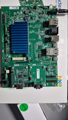

Share (also) a processor top view image, please
4,683 次查看
CrazyDeveloper
Currently, I have only this image. Please tell me if it will work or not. Otherwise, I can send a more clear image in few hours when I will back in the workspace
标记 (3)
4,673 次查看
JosephAtNXP
Hi @CrazyDeveloper,
I thought that SOM exposed the processor, I want to confirm the silicon revision, could you confirm with Verdin what silicon revision you have and if your silicon revision is compatible with the branch you built in Yocto?
