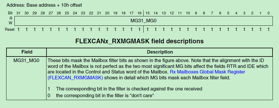

We want to offload the MCU and only read some of these messages by letting the HW filter out
So the HW should only accept the following IDs: 0x00000170, 0x00000171 and maybe 10 more.
Now in software the only messages I see available is 0x00000170, 0x00000171 and the other ones. The other messages is invisible because hardware did not accept them.
It seems the HW filtering can only cover ranges and that if we want to allow only 10 specific IDs we cannot do it. It this conclusion correct? And if it is what is the best way to offload heavy CAN traffic from the MCU?

Hui_Ma
In fact, FlexCAN ID can be flexible, that means your could filter/ignore any ID bits.
You also can do test with Rx Mailboxes Global Mask Register to set related ID bits checked or not.
Wish it helps.
