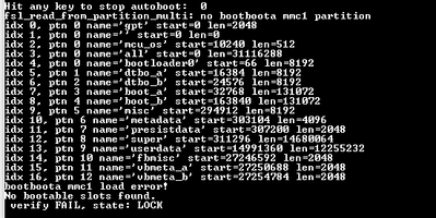

After flashing SD with my compiled sources according to this user guide:
android_Q10.0.0_2.5.0_docs/Android_User's_Guide.pdf
I configured the DIP switch and checked it several times for correction.
I booted up the device and encounered this terminal message.
At first it was stuck on a boot loop but after restarting it just stuck on NXP sign on the screen with this terminal message I attached.
What could cause this issue? How can I fix the flashed SD to boot correctly?
Let me know if there is any helpful information that can help you to identify the solution.
Thank you
1,758 Views
Bio_TICFSL
Hello ofir,
Please make sure that your SD is not in protection state, it looks like it is. also just erase everything in the SD before you burn again, and make sure it has 16GB of capability.
