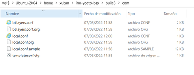

I have one more question regarding the building of an image with security features. I read in the documentation that I have to enable CONFIG_IMX_HAB=y
I don't know how to do that. My build environment does not contain any _defconfig file.
Thank you very much!
-Xuban
I attach my build environment

Xuban11
Where is the _defconfig file? I can't find it.
Thank you

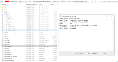

Based on the BSP version you are working is 5.10.72, if you want to find HAB block information, the path to find it should be at
L5.10.72_2.2.0_GA/imx-yocto-bsp/build-fb-imx6ull/tmp/work/imx6ull14x14evk-poky-linux-gnueabi/u-boot-imx/2021.04-r0/build/mx6ull_14x14_evk_optee_config\
and the .log name might be like u-boot.imx.log
Please feel free to reach out us, if you have any further question.
Harvey
8,077件の閲覧回数

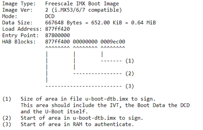

Xuban11
Hello sir,
I found the log file following the route you sugested, unfortunantly it doesn't contain the HAB blocks line.
Why is this? Where can I find HAB blocks information?
Thank you for your kind response,
-Xuban
I attach my log file (image1) and also how it should be according to the documentation i'm following (https://source.codeaurora.org/external/imx/uboot-imx/tree/doc/imx/habv4/guides/mx6_mx7_secure_boot.t...
