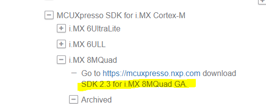

I think I've chased that link before:

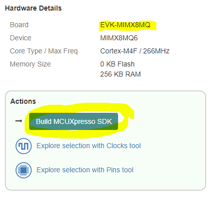

The link does NOT go directly to the file I was never able to find that file. I can eventually get a link that indicates "Build MCUXpresso SDK":

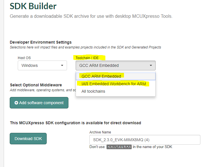

If you click on the link, the only options are for GCC ARM and IAR Embedded Workbench, not for MCUXpresso IDE [edit, originally wrote MCUXpresso SDK]:
If the referenced file "SDK 2.3 for i.MX 8MQuad GA." does exist, can you provide a direct link to it?

one can look at sect.4 Run a demo application using IAR, sect.5 Run a demo using ARM® GCC
attached Getting Started with MCUXpresso SDK document from this package.
I am afraid direct link is not available as package is built
when customer press "Download SDK" button.
igor
