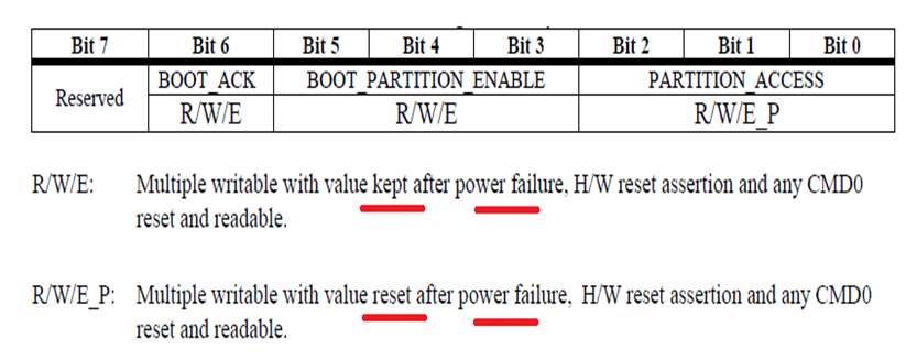

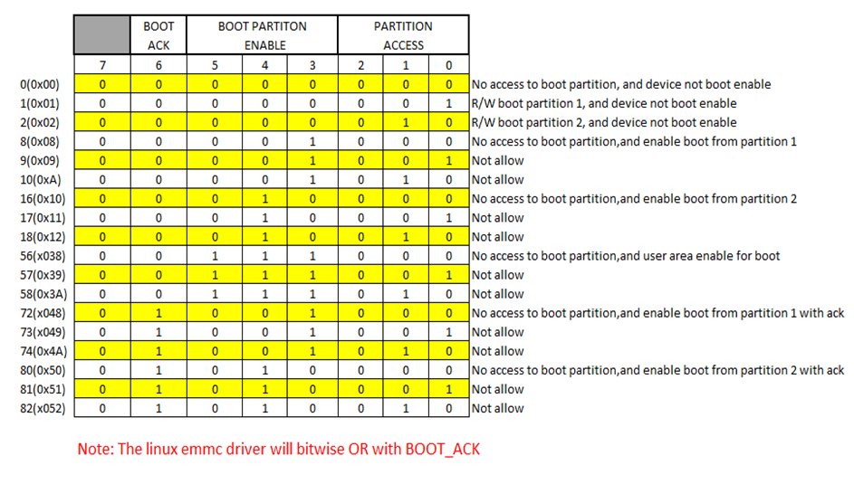

BiyongSUN
Oliver,
Could you please show me the emmc boot configuration?
emmc has boot partition, that is why we need to configure the boot partition.

BiyongSUN
your boot_partition:0x00; shows the boot configuration is wrong.
It seems you are using the BSP L3.0.35. It has some issue for emmc boot configuration. But can use a workaround of changing the command order in mfg tool xml.
But it is a workaround. not fix. it is under some cases. This workaround doesn't work all the time.
to fix, please check the item #2 below.
In the new BSP release 3.10.xx or 3.14.xx  kernel has no such issue.

2. to fix
    Modify the following code. and re-compile the kernel for mfg tool . and use the new mfg tool kernel to flash the emmc.
drivers/mmc/core/mmc.c
setup_boot_partitions
err = mmc_send_ext_csd(card, ext_csd);  // The setup_boot_partitions is trying to filter  wrong value  but  back door here.
.....                                                                  //  it reads back the value may contain the PARTITION_ACCESS bit by  echo the force_ro
/* enable the boot partition in boot mode */
/* boot enable be -
  * 0x00 - disable boot enable.
  * 0x08 - boot partition 1 is enabled for boot.
  * 0x10 - boot partition 2 is enabled for boot.
  * 0x38
switch (part & EXT_CSD_BOOT_PARTITION_ENABLE_MASK) {
break;
case EXT_CSD_BOOT_PARTITION_ENABLE_MASK:
  boot_config = ((ext_csd[EXT_CSD_PART_CONFIG]
    | EXT_CSD_BOOT_PARTITION_ENABLE_MASK)
    & ~EXT_CSD_BOOT_ACK_ENABLE);
  break;
default:
  printk(KERN_ERR "%s: wrong boot config parameter"
   " 00 (disable boot), 08 (enable boot1),"
   "16 (enable boot2), 56 (User area)\n",
   mmc_hostname(card->host));
  err = -EINVAL;
  goto err_rtn;
                          boot_config = boot_config  &  0x78;   //   Let PARTITION_ACCESS = 0
err = mmc_switch(card, EXT_CSD_CMD_SET_NORMAL,
  EXT_CSD_PART_CONFIG, boot_config, card->ext_csd.part_time);
The following is from the emmc spec.
