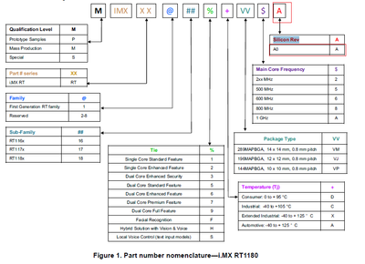

Hi Jett, your chip is  PIMXRT1189CVMBA, means Silicon Rev is A0.
I consulted an RT1180 series expert, His response was "The RT1180 A0 chip cannot use the latest SDK library, and the latest SDK library can  be used by the RT1170 B0 ".

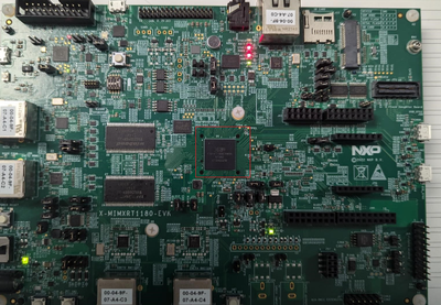

jett
Mayliu,
I'm using the default jumper configuration, I'm following the guidance from those documents. I'm using the MIMXRT1180-EVK board with the following tags on the back; SCH-50577 REV B and 700-50577 REV x5. The SDK version is 2.16, MCUXpresso IDE is 24.9.25. I was using the evkmimxrt1180_rgpio_led_output_cm33 project but I have tried around 10 example projects and they all work only if I comment out the EdgeLock_SetClock function. I have tried the evkmimxrt1180_rgpio_led_output_cm7 project. I'm using the LinkServer MCU-Link USB.
I have attached my setup as well as where I break point at and what error I get after I hit continue

Hi Jett, Please  take a picture of the silk screen on the chip of the NXP1180. It would be better if you print it out.

I have attached a photo and it is written down below
PIMXRT1189CVMBA
0P96D
CTZA2221D
I did a little more digging.
The kCLOCK_RootEdgelook  div is 3  and kCLOCK_RootEdgelook  mux is 1 on boot
Inside of ELE_BaseAPI_ClockChangeStart
S3MU_SendMessage comes back as successful however
the response from ele_mu_get_response_baseapi contains 0xf429 at rmsg[1] instead of 0xd6 (RESPONSE_SUCCESS).

jett
Ahh of course, thank you for your help!
