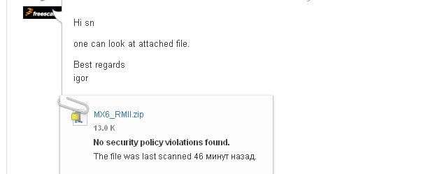

igorpadykov
Hi sn
one can look at attached file.
igor

4,544件の閲覧回数
ngisp
igor ...where is the attached file..m unable to find it ...
4,544件の閲覧回数
igorpadykov
you should see in previous thread picture below
then click on MX6_RMII.zip
4,544件の閲覧回数
ngisp
thank igor...got it ...previous thread was not showing it .
4,544件の閲覧回数
ngisp
Hey thanks igor issue resolved  as continuous ping was failing from uboot too :smileyconfused: we cross checked with hardware details and were able to make it work now.
