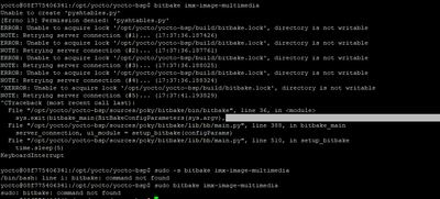

Sousa
I've tried following those steps and I always end up at the same deadlock. I am not able to run any commands without sudo, even bitbake and even when I use sudo -s with the command, it returns a command not found.
As you can see per this picture, I get permission denied if I don't use sudo, and when I do, "command not found". I follow the guide, I followed the docker in the guide which is what I used to base my several test grounds but I have not been able to progress further.
