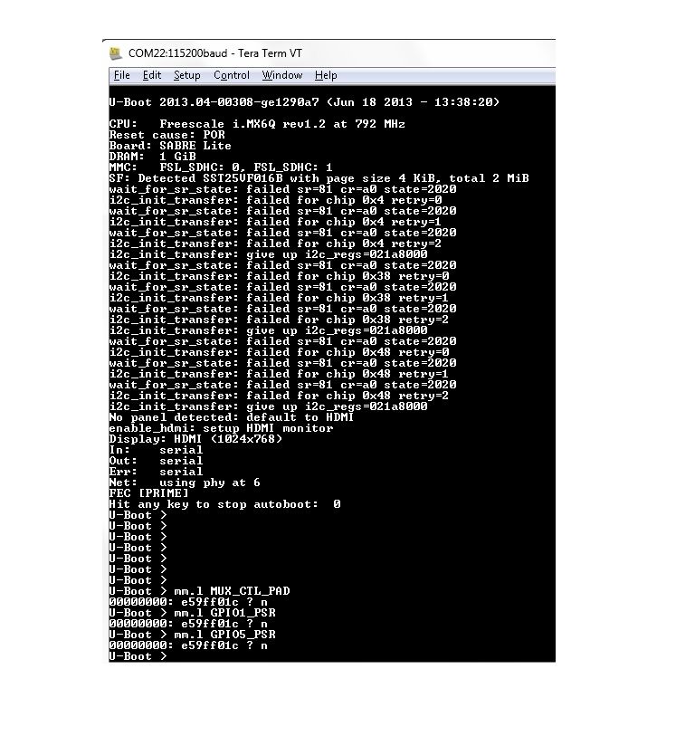

We are getting error while booting the IMX Saberlite 6Q from SD card.
Below is the error log.

We changed the kernel image and try but it gives the same error. We are using Kernel 3.0.35.

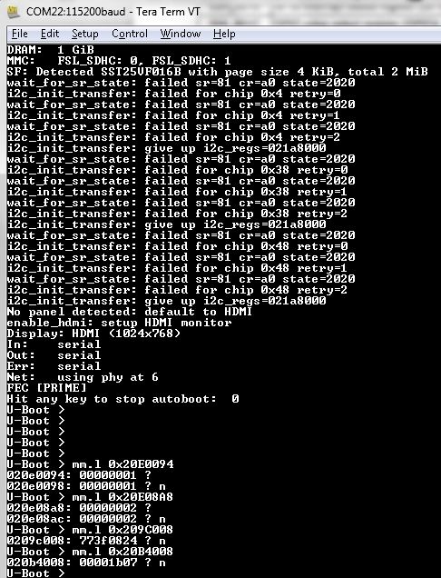

We have tried to read the MUX_CTL_PAD and GPIOx_PSR registers from the u-boot prompt.
But we are getting the same values for all registers.
Could you please take a look and check if we are reading it correctly and what do the read values indicate?

The mm.l command expects an address as its argument. You can find the addresses in the reference manual i.MX6DQRM.

Hi Eric,
We have read the below mentioned registers.....
1. IOMUXC_SW_MUX_CTL_PAD_EIM_DATA17 @ addr 0x20E0094
2. IOMUXC_SW_MUX_CTL_PAD_EIM_DATA18 @ addr 0x20E0098
3. IOMUXC_I2C3_SCL_IN_SELECT_INPUT @ addr 0x20E08A8
4. IOMUXC_I2C3_SDA_IN_SELECT_INPUT @ addr 0x20E08AC
5. GPIO1_PSR @ addr 0x209C008
6. GPIO7_PSR @ addr 0x20B4008
Could you please take a look at the read values and see if anything is missing.
Please see the image for corresponding read values.
