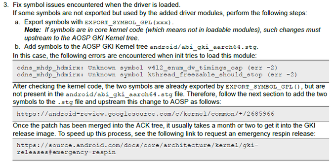

I want to connect a peakcan to the mek board. I realized that there is not peak_usb module included. So, I added to device/nxp/imx8q/mek_8q/automotive_addition_car2_defconfig file this line:
CONFIG_CAN_PEAK_USB=m
Also, I add this line to device/nxp/imx8q/mek_8q/SharedBoardConfig.mk file
#CONFIG_CAN_PEAK_USB
BOARD_VENDOR_KERNEL_MODULES += \
$(KERNEL_OUT)/drivers/net/can/usb/peak_usb/peak_usb.ko
This adds the module to /vendor_dlkm/lib/modules/peak_usb.ko
When I try to run insmod I got this errr:
insmod: failed to load ./vendor_dlkm/lib/modules/peak_usb.ko: No such file or directory
When I saw the dmesg, this gives this information:
[13549.962243] peak_usb: Unknown symbol can_get_echo_skb (err -2)
[13549.969056] peak_usb: Unknown symbol driver_for_each_device (err -2)
I run these commands:
mek_8q:/ # /proc/kallsym
cat /proc/kallsyms | grep can_get_echo_skb
0000000000000000 r __export_symbol_can_get_echo_skb [can_dev]
0000000000000000 t can_get_echo_skb [can_dev]
0000000000000000 t __can_get_echo_skb [can_dev]
mek_8q:/ # cat /proc/kallsyms | grep driver_for_each_device
0000000000000000 T driver_for_each_device
Here, I'm not really sure what is going on. It seems to me that the modules is loaded. I have perform multiple test check like de CRC in Module.symvers and in peak_usb.mod.c both seems to be the same. I'm not really sure if this is a SELinux policy because I run setenforce 0 and got the same error
I will appreciate any help.

Hi  Reymor:
Just an information to you, in the android user's guider,  there is some description about how to add new drivers.  please see section 9.4.
If some symbols are not exported but used by the added driver modules,  some suggested steps can be performed.
https://www.nxp.com/docs/en/user-guide/ANDROID_USERS_GUIDE.pdf
