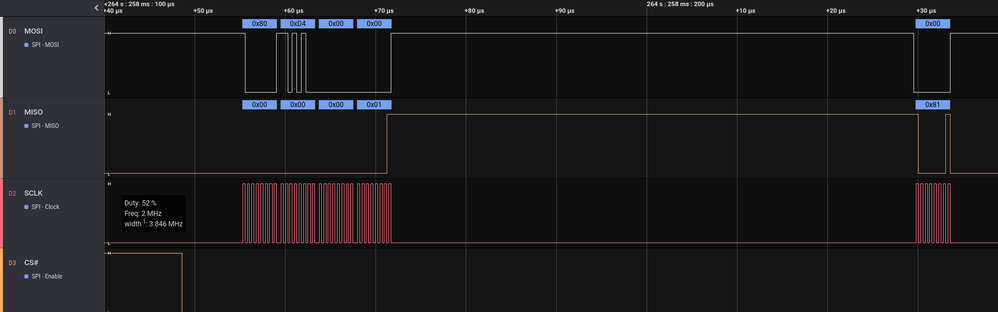

Hello NXP team,
I've been trying to set up lpspi0 in a i.MX8QXP-MEK (CPU + BaseBoard) connected to a SLB9670 TPM2.0 device thorough the Arduino Header port in the BB (J29) with DMA. Device was correctly detected, but I've been having DMA setup problems, and spi config is switching to PIO:

Currently using CS as GPIO - as seem in the node for the NOR flash in imx8qm-lpddr4-val-lpspi.dts, which has been working as expected. Changing the default assigned-clock-rate property to 60000000 was effective in achieving the desired up the clock line the the SPI slave (2[MHz]).
LPSPI0 bus activity between processor and SLB9670 device.LPSPI0 bus activity between processor and SLB9670 device.
What could be the cause of the DMA error in this scenario?

Hi @guilhermes,
Could you please check if there is another device-tree node using SPI gpio?
Dhruvit.

guilhermes
Hello @Dhruvit, we checked and there is not another device-tree node using this SPI. But we managed to get the communication working; seems to be a signal issue in our hardware.
Thanks and sorry for the late reply!
