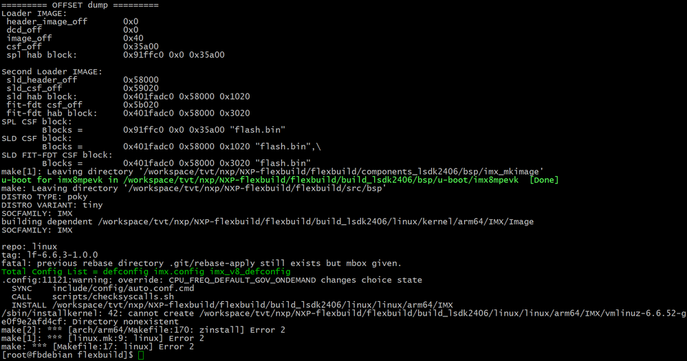

Trying to build Debian FlexBuild using docker container with the commands:
$ cd flexbuild
$ . setup.env
$ bld docker
$ . setup.env
$ bld bsp -m imx8mpevk
Have the following result:
What am I doing wrong?
Unfortunately I couldn't find any build log to attach to my question...
The host system is Debian 12.
Thanks!

As your host system is Debian, you don't need to use docker. The docker should be used if your system is Ubuntu and you want to build deep learning feature.
Please delete the build_lsdk2406 folder to avoid permission issue and then build it with below three commands.
$ cd flexbuild
$ . setup.env
Zhiming

I tried to build the FlexBuild from scratch in two ways: using Debian 12 system and using Docker container. Have the following results...
Debian 12 build:
FlexBuild-D12.pngDebian 12 build
Docker build:
FlexBuild-Docker.pngDocker build
Could you give me a clue where am I wrong? Thanks!

You can try to create that folder in flexbuild. Did you modify the flexbuild source code?

Of course I did create that folder manually but there was another error which I unfortunately didn't document. And I didn't modify any part of FlexBuild source code.
