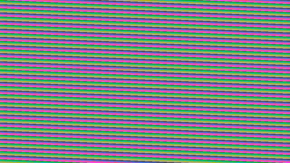

I've also tried the native android camera application, which gives the same error. However, it tries to open the camera again by forcing some settings which does display an image. However the image is broken like so:
The image is supposed to be a test image (standard color bars) from the image sensor. It looks like the rows are all messed up. Which makes me believe the default camera app may be guessing at the row count?

1E is the correct MIPI type, however is "ffffff1E" correct? Should it be "1E1E1E1E"? Or something else? The image is a 1920x1080@30 stream using 4 lanes. From what I can tell this is correct output from the Mipi and IPU registers.

You are using MX6Q? the you have a none supported camera mode.
