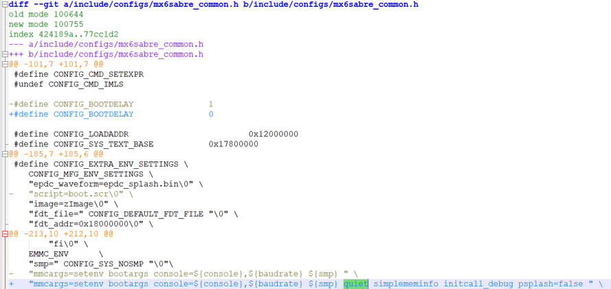

1.We have enabled uboot bootdelay but we are unable to stop Autoboot with a key press.
Please guide us how we can stop uboot autoboot so we can get command shell.?
Steps we did below to enable uboot logs:

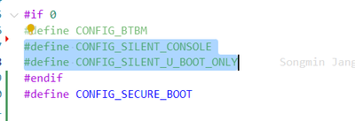

We have disabled below definitions from uboot config header and define secure boot
Added boot delay in uboot config header (highlighted area)

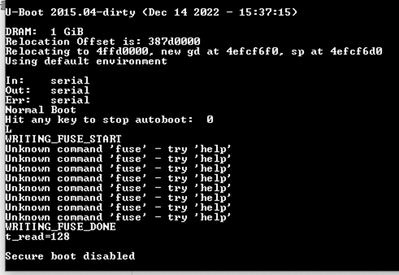

 2.We believe fuse is only one time writeable and write command is like "fuse prog -y 3 0 0xD9B3DFC9".
We have tried to write the command as boot command but below error observed.
Code snippet:
Fuse command is missing. How we can resolve it?

For #1, have a try to remove "quiet" option from mmcargs.
For #2, refer to below link.
https://community.nxp.com/t5/i-MX-Processors-Knowledge-Base/Q-A-How-to-program-i-MX6-eFUSE/ta-p/1121...
In config header there is no mmcargs found and we have removed quiet from bootargs. But still unable stop uboot from Autoboot and unable to get command shell.
"bootargs=console=ttymxc3,115200 root=/dev/mmcblk3p1 rootfstype=ext4 rootwait ro video=mxcfb0:dev=ldb,if=RGB24,bpp=32 simplememinfo mem=992M mmc_skipinit_setup psplash=false \0"
