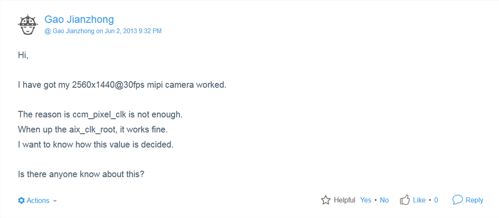

According the AN5305 doc, setting the MIPI DPHY clock (CSI2_PHY_TST_CTRL1)
ex: https://community.nxp.com/thread/307065#328301
- mipi_csi2_write(info, 0x00000014, CSI2_PHY_TST_CTRL1);
+ mipi_csi2_write(info, 0x00000008, CSI2_PHY_TST_CTRL1);

weidong_sun
Hi, Jimmy Chen,
   The issue should be related to the MIPI Clock setting, customer's log "mipi csi2 can not reveive data correctly!", means data not correct, that is data has been received, but not correct.
   So my advice is try to modify the clock root of MIPI CSI2 module.
   On the link, https://community.nxp.com/thread/307065#328301 , you can see Gao Jianzhong's experience :
   So suggest you'd better try to modify MIPI CSI2's clock ROOT.  you can find source code of  i.MX6Q's clock tree at path "arch/arm/machimx/" or "drivers/clk/..."
