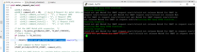

Hi Sir,
I refer to the NXP EasyEVSE EV Charging Station Development Platform User Guide (CCEVCPGSUG.pdf) file to build the EVSE system
Ask me, if you must connect through AZURE CLOUD to carry out DEMO.
I try to disable the SE050(remove initial code) & NFC(CLEV663=0).EVSE_SAS_AUTH  set 1.
#define EVSE_SAS_AUTH 1
The sample code will hang @meter_request_now.
If I just want to check the meter function(KW35), is it possiable (without Cloud, NFC, NFC)?

Hi @StephenYeh
Eventougth demo is shipped to work with  all elements (NFC, Cloud, SE050 at least for generating random numbers, meter) It is possible to only get RT1060 and KM35 Meter . We need to ensure to have proper modifications
I will get back to you with instructions for this.
Thank you for your patience and for your interest.
