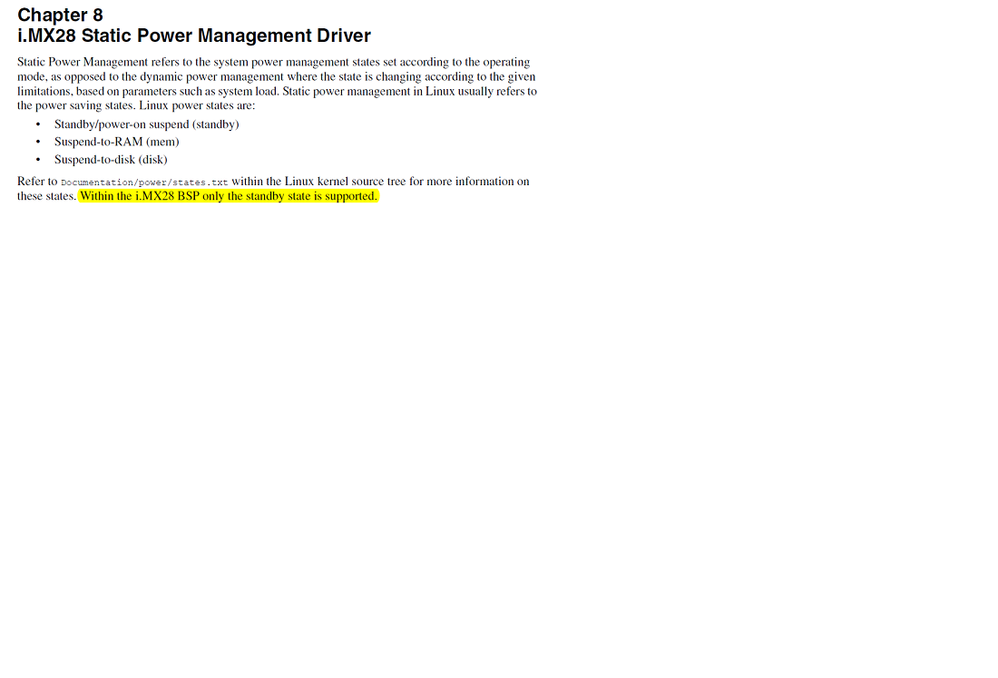

How to TEST Power-Save Mode in i.MX28 EVK hardware.?
Can Power-save mode using USB-5V Power source?
please let me know.

To put the entire system into standby mode, run the following command:
# echo standby > /sys/power/state
Chapter 8 (i.MX28 Static Power Management Driver) of "MX28_EVK_Linux_Reference_Manual.pdf".
https://www.freescale.com/webapp/Download?colCode=L2.6.35_1.1.0_LINUX_DOCS&location=null&fpsp=1&Pare...
Power saving modes may be applied under USB-5V.

i want to TEST "Suspend-to-RAM (mem)" Mode.
But set to mem mode, no change mem mode.
How can i do mem mode TEST!
please refer to the below message..
root@freescale ~$ echo mem >/sys/power/state
PM: Syncing filesystems ...
done.
Freezing user space processes... (elapsed 0.00 seconds) done.
Freezing remaining freezable tasks ... (elapsed 0.00 seconds) done.
Suspending console(s) (use no_console_suspend to debug)
USB Host suspended
USB Gadget resumed
USB Host resumed
pm_op(): usb_dev_resume+0x0/0x18 returns -108
PM: Device usb1 failed to resume: error -108
Restarting tasks ... done.
root@freescale ~$

From section 3.1 (New Features) of i.MX28 EVK Linux Release Notes
(MX28EVKLRN,Rev. L2.6.35_1.1.0, 02/2013) :
“Add suspend-to-RAM support”.
Next, the following is
Kernel Configuration:
    System Type  --->
        Freescale i.MXS implementations  --->
            support MX28 suspend-to RAM feature
In the original EVK design, DRAM power source is provided by the on-chip power supply
and it will be turned off during mem mode. In order to support suspend to RAM, it must be
connected to a constantly on power source rather than the on-chip power supply.

your mean, do i select "S1" is lower, right?
S1: Battery source selection switch
Upper position: real 4.2V Li-ion battery using J85/J86.
Lower position: simulated 4.2V battery with on-board EVK 4.2V regulator.
thnaks,
3,843 Views
Yuri
S1 defines if the whole board will feed from a battery. For suspend-to-RAM mode it is necessary to power
DRAM only (and maybe RTC), when all the rest supply is OFF. The i.MX28 EVK does not support such mode.
