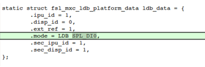

if you need to use higher resolution, try to use split mode, and don't forget add your lvds timings in the bsp, for more detailed information, pls refer to the Chapter 7 LVDS Display Bridge(LDB) Driver of enclosed file

Thanks Joanxie, as per your reply I have update LVDS to split mode as you can observe in below screenshot:

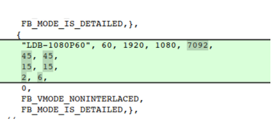

As well as updated clock w.r.t new display datasheet as below:
As well update u-boot to run LDB-1080P60 for full HD (1920x1080) with 60Hz refresh rate.
Let me know any other changes required.
