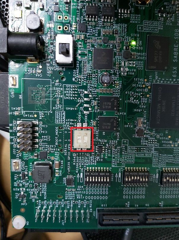

The boot mode switch has been changed to Serial Download mode.
(BOOT_MODE0[D1] : ON / BOOT_MODE1[D2] : OFF))

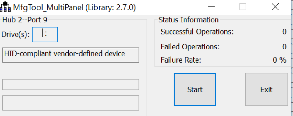

Then, when boot up the board, Windows 10 installs the (Freescale SE Blank PELE) driver, but the MFG Tools are forced to terminate.
LOG : MfgTool_Crash.log
Question. How can I download binaries to SDCard on the MCIMX6SX-SDB board using MfgTool?

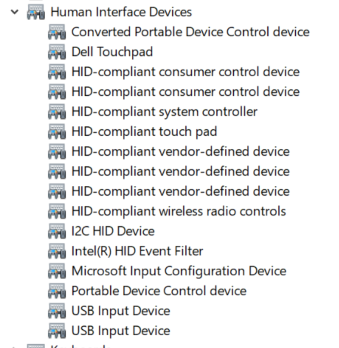

refer to the user guide,  No dedicated boot DIP switches are reserved for serial download mode on i.MX 6 SABRE-SD and i.MX 6SoloLite boards, then when you connect your board with PC, check if you can find ""HID-compliant vendor-defined device" in the device manager, if you have issue for installing the driver, you need to check your PC, my win10 can install the driver successfully

4. The MFG_Tool is terminated...
2~4. screen capture : http://shorturl.at/acmLP

you don't need to change the boot mode as your picture shows, my board's setting is 1=OFF, 2=ON

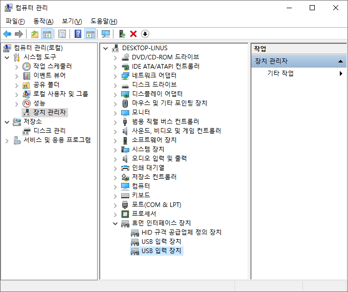

my laptop is  win10, everything is ok on my computer, did you check the driver installation successfully?
4,875 Views
donghyunkim
Hi, Joan Xie.
I got several windows 10 and tested them.
But it doesn't work.
Do you have a driver for Windows 10?

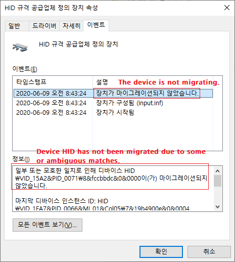

There is an event that failed migration in HID.
Please check again.
Thanks.
ps. The specification of my Windows 10 is "Windows 10 Pro / 1909 / 2020-02-24 / 18363.900"

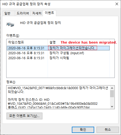

⨁ add contents : The migration was resolved with the "sfc/scannow" command, but the MFGTool problem is not solved.
