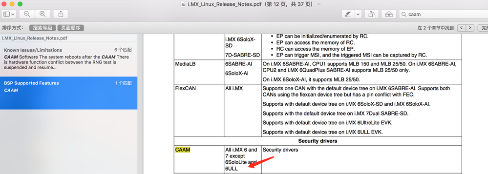

Dear all,
      Now I try to port BSP from iMX6UL to iMX6ULL,but always occur kernel panic after load CAAM driver.
      Log as follows,

Load CAAM driver failed, then I find some info in this doc. Dose it mean iMX6ULL not support CAAM feature?

Hi Shi,
The i.MX6ULL does not have CAAM, you need to remove that driver.
