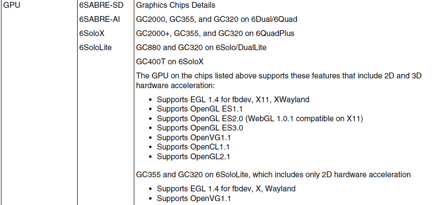

    Does imx6 sololite with GPU,like MCIMX6L3DVN10AB ,support OPEN CL? If the answer is YES, which version of OPEN CL does it support?
     I know IMX6Q support OPEN CL, but the GPU of IMX6L3D seems not the same as IMX6S/D/Q. I don't know if IMX6L3D support OPEN CL or not. Are there any technique docements?
     Thanks.

I would verify that MCIMX6L3DVN10AB actually has 3D support because datasheet indicates 2D + OpenVG only. Therefore no Open CL, furthermore beware on most i.mx6 processors Open CL is restricted to the EP (Embedded Profile) which severely limits its capabilities.

In the newest linux BSP, details you can see in document i.MX_Linux_Release_Notes.
Hope this can do help for you.
