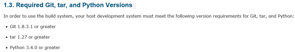

anaseem
From Yocto Project Quick Build,   'Python 3.4.0 or greater'
Which Python is it referring to?  python, python2, or python3 ?

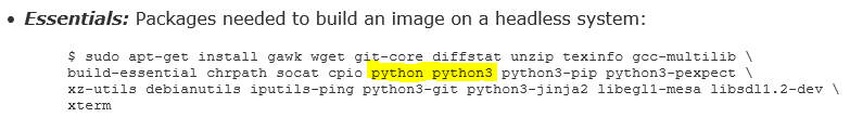

Hi all,
by the way, I have generated for Ubuntu Desktop 16 and currently trying 18, it seems that section 3.1 could be complemented with information;
For Ubuntu 16.04 and 18.04
apply "Essential Yocto Project host packages",
then "i.MX layers host packages for a Ubuntu 14.04",
and finally invoke "sudo apt-get  install curl"
For Ubuntu 18.04:
invoke also "sudo apt-get  install python"
Hope it helps
Laurent

anaseem
"Yocto project  user's guide" directed me to "Yocto Project Quick Start" which requires to install Python 3.4.0 or greater.  Is version 3.4.0 for Phython or Python3 ?   I think it is Phython3 because version number starts with numeral 3 ?
Amer

LaurentBardet
python (short name for python2) is also required.

Bio_TICFSL
Python3, refers to python 3.4.0 or more as its update by Ubuntu.
